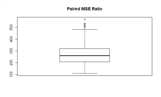

It is possible to simulate this hundreds of times to show that this wasn't just a fluke.

boxplot(in_sample, out_of_sample, names=c("in-sample", "out-of-sample"), main="MSE") summary(in_sample) summary(out_of_sample) summary(out_of_sample/in_sample)
The model has overfit badly every time.
In-sample MSE summary
   Min. 1st Qu.  Median    Mean 3rd Qu.    Max.
  3.039   5.184   6.069   6.081   7.029   9.800
Out-of-sample MSE summary
  947.8  1291.6  1511.6  1567.0  1790.0  3161.6
Paired Ratio Summary (always (!) much larget than 1)
  109.8   207.9   260.2   270.3   319.6   566.9
