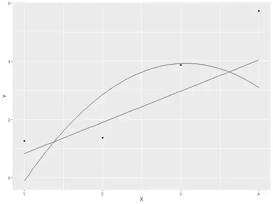

Now we have a much higher Adjusted R-squared: 0.7133 which may lead us to think that the model is much better. Indeed if we plot the data and the predicted valus from both models we get :
> fun.linear <- function(x) { coef(m0)[1] + coef(m0)[2] * x  }
> fun.quadratic <- function(x) { coef(m1)[1] + coef(m1)[2] * x  + coef(m1)[3] * x^2}
> ggplot(data.frame(X,Y), aes(y = Y, x = X)) + geom_point()  + stat_function(fun = fun.linear) + stat_function(fun = fun.quadratic)
So on the face of it, the quadratic model looks much better.

Clearly the linear model still performs well, but the quadratic model is hopeless outside the orriginal range. This is because when we fitted the models, we had too many parameters (3) compared to the number of observations (4).
