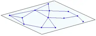

Or more general each member can be part of up to three 2D locally euclidean planes of 2 different dimensions each.
[pic1]
(each of those planes is cyclic in two orthogonal directions, like a torus)
Given just one member it could look like a node network:
(just one node with some neighborhood displayed here. Those neighbors have again neighbors not displayed here)

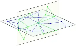

(left: 1 plane, right intersection of 2 planes)
enter image description here enter image description here intersection of 3 planes:
Despite that there need to be some deterministic way to map the neighborhood of a node to planar graphs at those three 2D euclidean planes (with constant node density). So adjacent node neighbors tend to be neighbors as well and have no $n$-neighborhood growth which needs e.g. hyperbolic space for representation.

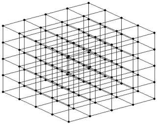

If e.g. the number of neighbors from one node is set to a fixed value of 6 we get a structure like this:

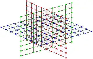

(left: intersection of 3 planes at a single node/number, right: every node/number has this structure here)
intersection of 3 planes at a single node/number. Each generator is equal to one direction of progression. A plane is all possible values by using two generators other than at the more general structure above any number/node has the same structure here. So every number has 3*2 possibilities of progression with 3 generators and their inverses
This can be achieved with 3 generators and a suitable $\bmod P$ as listed below.

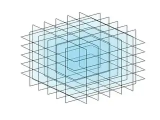

With (a lot of free time) we could draw the neighborhood structure onto sheets of paper (=euclidean plane).
We can measure a (euclidean) distance in between nodes with our ruler. No matter of how many neighbors of neighbors we draw the mean distance in between nodes should stay (about) equal.
If we tape two opposite paper edges together we can simulate the cycle property for one direction. Considering this option the (min) distance in between two specific nodes is always equal - no matter were we started drawing this structure. (After drawing the full cycle in two direction we have to cut the paper to the proper size. At the border we continue the measure at the opposite border of the paper).
One node can only be on up to 3 sheets. If multiple numbers are on two different sheets (2-tori) they all lay on one line (1-torus) - like at the intersection of two 2-tori.
