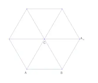

In euclidean space mirroring a triangle around point ($C$) would look like this:
Frist mirror $A$ at $CB$. Then mirror $B$ at $CA_M$ and so on. If it is a equilateral triangle it will match up again after doing this 6 times.

From the second triangle, we can find an neighbouring triangle that has the same orientation as the first one (all the points will be shifted by the same vector). So we are interested in finding a path between one distinguished corner or the two triangles. It forms a two-dimensional lattice: e.g. $A_M$ can go to $A$ or to it's upper counterpart (on the continuation of $BC$). These two vectors form a basis. We can also include the third vector (going from $A_M$ down through two triangles): it is "redundant" but we need it since we want to find short coordinates, and these three vectors cover all 6 directions.
Now we just want to express the vector connecting the distinguished corner of the two triangles, in our (redundant) basis. This already should hint towards weakness of the problem, since we "just" need to find 3 numbers (coordinates in the basis), i.e., the order of steps does not matter.
This leads to CVP (close vector problem) instance, which can be solved by Babai's algorithm and LLL (you would have a few extra dimensions for coordinates and to add the modulus reduction into the lattice).
Going into higher dimensions might make LLL less effective. I don't know the details about that, but it seems that the basis we have is already reasonably good, so that LLL should find very good decompositions of paths.

    Oh dear how could I miss that, I also thought something like that ( shifted by same vector) and tested it with some example. It didn't work out at that point. I did the mistake to compare triangles after 3 reflections but to get the same shape only 2 reflections are needed. Thank you for pointing that out again. rip idea. I guess there also exists no similar but much more secure alternative. – J. Doe Nov 29 '21 at 18:39
