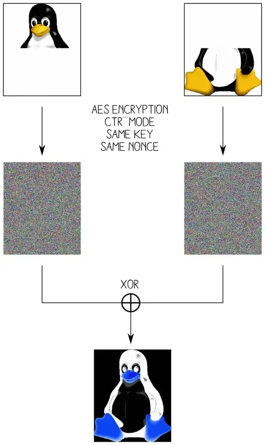

Security fail of Non-SIV-mode ciphers based on AES-CTR by leaking plaintext xors when re-using nonce.
proof
