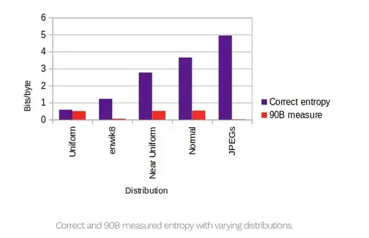

We can interpret the 800-90B tests as rubbish.
The tests do not work effectively on any real world correlated or non uniform entropy data. These are the findings of John Kelsey, Kerry A. McKay and Meltem Sönmez Turan, Predictive Models for Min-Entropy Estimation, and Joseph D. Hart, Yuta Terashima, Atsushi Uchida, Gerald B. Baumgartner, Thomas E. Murphy and Rajarshi Roy, Recommendations and illustrations for the evaluation of photonic random number generators. They produce the following summaries, showing the massive under estimations the tests produce:-
and from my own testing, a chart confirming a similar magnitude of errors:-
In short, the more the raw entropy deviates from IID (as is common in the real word), the greater the errors 90B produce. This climaxes in a 215 fold error for the entropy measure of a JPEG file. It is not surprising then that no one can find any examples of 90B being applied in the wild, as demonstrated in Any concrete examples of the use of NIST Special Publication 800-90B?
I'm excluding the Shuangyi Zhu, Yuan Ma, Tianyu Chen, Jingqiang Lin and Jiwu Jing Analysis and Improvement of Entropy Estimators in NIST SP 800-90B for Non-IID Entropy Sources paper as they use a Markov model for simulation data which seems inappropriate to a critique of said model. However, they effectively reach the same conclusions (just less so).
