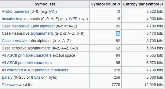

I read this wiki article and saw this formula for random password's information entropy. Also the wiki article mention that the symbol count for non case sensitive is 36. Is there a way I can calculate the password space with this information.Entropy per symbol for different symbol sets random password's information entropy
    The password space isn't something you calculate; it's just the set of all strings consisting of eight alphabet characters (case insensitive). The size of the password space is 26**8, or about 209 billion. And if you want to know the amount of entropy of such a password selected uniformly at random, then that would be 4.7 entropy bits per character × 8 characters = 37.6 bits. (In the equation you provided, L=8, and N=26.) – r3mainer Mar 01 '18 at 10:59
  • @squeamishossifrage Where L is the length of the password and N is the number of possible values for a character. – DannyNiu Mar 01 '18 at 14:24
  • So what would case sensitive 8 character would look like. (26^8)*(26^8) – socrates louis Mar 04 '18 at 23:55
  • @socrateslouis If you allow mixed case, then you are using an alphabet of 262=52 characters. So the number of possible 8-character passwords is 52*8 ≈ 53.46 trillion. – r3mainer Mar 06 '18 at 10:15
