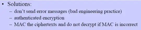

The actual solution to this problem is message authentication, not making the IV secret. A secret IV really only protects the first block. Message authentication protects the entire message. Message authentication can be done through HMAC on the ciphertext, or by use of an authenticated encryption mode.

To answer the question. Part 1: no it is not safe. Part 2: yes it is safe, but not helpful. Use a MAC or authenticated mode instead of trying to solve an IV problem that already has a solution. This image is directly from the video you referenced:
