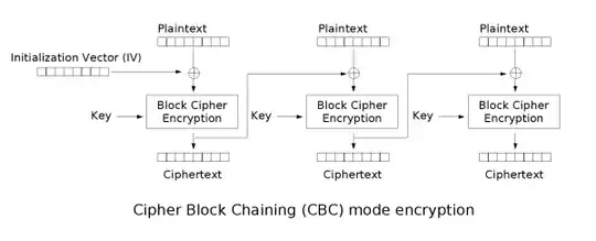

Lets take a look at what happens for CBC mode encryption:
As you can see, IV is called the Initialization Vector because it is the first vector that is mixed with the plaintext before encryption. The next vectors are the cipher text block before the one that is being encrypt. All of the ciphertext blocks are of course send in plain. Because of this it doesn't make sense to encrypt the very first one - you would only protect one of the many vectors.
What you can do for CBC mode encryption is to use a PRP (block cipher) or PRF (cryptographically secure hash to make the IV less distinguishable from random. The IV for CBC mode encryption must be unpredictable (to an adversary). In that case however you never decrypt the IV, you use the block cipher simply as an initial transformation.
