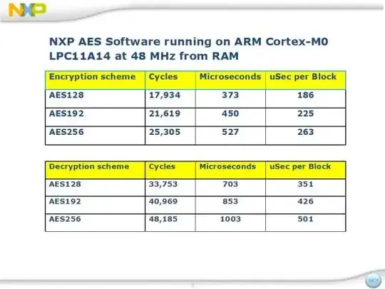

  • So your platform is ARM Cortex-M0 LPC11A14 at 48 MHz or similar? – LightBit Mar 18 '15 at 18:41
  • @LightBit Yes, but I underclocked to 12 Mhz instead of 48, and Im not running from RAM but from FLASH, so I will never reach those numbers. – Maestro Mar 19 '15 at 08:47

  • @Muis I think ChaCha is the best choice for this CPU. DES, LED, PRESENT, and Piccolo are fast in hardware, but slow in software. RC4 is good for 8-bit CPUs. – LightBit Mar 20 '15 at 21:40
Salsa/ChaCha and the other eSTREAM winners are likely to be the "fastest but still secure" options today.
Don't forget authentication of course. Reduced-round ChaCha/Poly1305 is likely to be the fastest software-only option, due to tuned implementations in the libsodium and NaCl libraries.
UPDATED: The following slide deck has good info on state of the art lightweight block ciphers vs. legacy (along with source code links). Considers code size, RAM, and cycles/byte metrics for many algorthims).
Stream ciphers such as those from eSTREAM may be a better option than block ciphers. Even choosing RC4 and hardening it by dropping the first 512 bytes may be a good solution; code size doesn't get much smaller than RC4.
