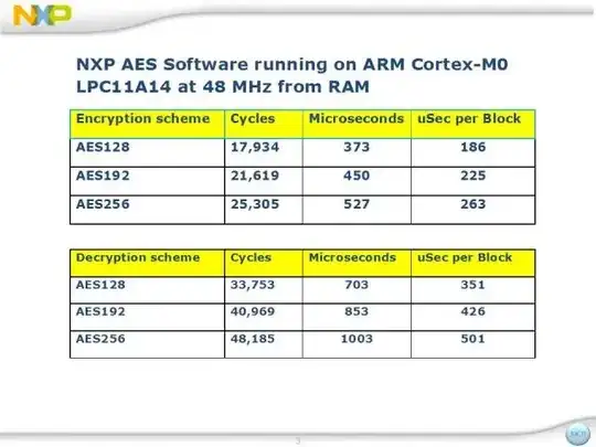

  • yes but he does not have the instruction set which makes cbc faster, and if it's just for encryption on the device there's no problem, decryption is a bit slow though. It does not show how fast GCM is on the ARM Cortex M0 but it does show CBC and ECB https://realtimelogic.com/products/sharkssl/Cortex-M0/ which is decent right? – Vincent Mar 17 '15 at 07:19
  • The Cortex looks pretty fast for AES, but I don't know the requirements. @cpast I'm pretty sure OCB beats GCM (and I certainly hope that this is not a defensive device). GCM may not be fast on embedded, but as the Cortex is 32 bit the performance could be better than the 8/16 bit counterparts. – Maarten Bodewes Mar 17 '15 at 17:36
  • @MaartenBodewes Its an Cortex M0 running at 12Mhz, so its not so fast. And I need to save battery. I was in doubt between RC4 and XXTEA and I picked RC4 now. It seems good enough. – Maestro Mar 17 '15 at 18:50
