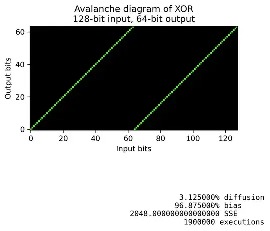

Diffusion of $a \oplus b$
As you guessed; with plain XOR, the output bit $c_n$ is only affected by input bits $a_n$ and $b_n$. Here's what that looks like.
Avalanche diagram of XOR

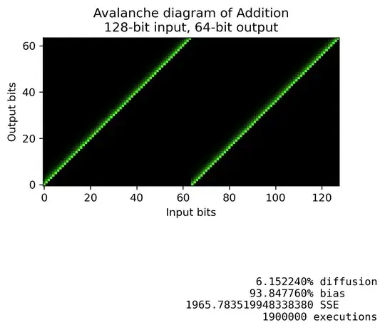

Diffusion of $a + b$
A slight improvement is addition. You can see that instead of each bit only affecting itself, there is now a very slight diffusion around the bits.
Avalanche diagram of addition

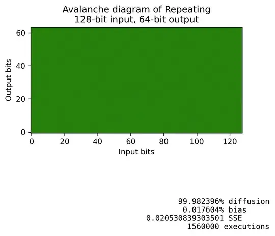

Diffusion by repeating simple mixers
If you take a bunch of invertible operations that somewhat diffuse the changes, and repetitively perform them, you can get much better results.
Below is an example with just XOR-shifts and add-shifts.
Avalanche diagram of repetition
Here's the operations that are being performed. As you can see, individually none of those diffuse that much, but if you repeat them enough, the mixing is much better.
for (size_t i = 0; i < 4; i++) {
    // Mix a
    a ^= a >> 7;
    a += a << 13;
    a ^= a >> 9;
// Mix b
b ^= b &gt;&gt; 7;
b += b &lt;&lt; 13;
b ^= b &gt;&gt; 9;
// Shift a and b into each other
u64 a_old = a;
u64 b_old = b;
a = (a_old &lt;&lt; 8) | ((b_old &gt;&gt; 56) &amp; 0xFF);
b = (b_old &lt;&lt; 8) | ((a_old &gt;&gt; 56) &amp; 0xFF);
u64 c = a ^ b;

  • It looks like in last diagram all pixels are green, but some are lighter. How to interpret that? Does it shows some bits are mixed less often?

  • Ok, the figures are confusing. X-or is fine, however, modular or not, addition can effect more than one bit and that is really depend on the size of modulus $n$ where it seems $2ˆ{64}$ – kelalaka Oct 18 '22 at 05:35
