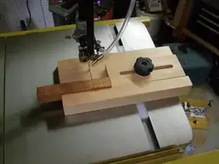

Consider the features of this jig\sled on a bandsaw.
mitre sled
The wood in the picture is being held against two fences. Rear fence holds the work 90 degrees to the blade and the other fence is adjustable (see the wheel) to help move the cut in or away from the blade.
Your cups are not flat (at least not the one pictured) so you will need to modify this design. When cutting into curves you need to prevent the cup from rolling around so an easy way to get that is to have two blocks angled into each other (like chucks on a car or plane wheel).
Made in sketchup to illustrate the design
Cup has somewhere to rest and the adjustable fence will give you something to push against to make sure the cut is straight. That design only covers your first cut examples though.
Getting mugs of a uniform width makes this part so much easier to mitigate. A jig would be useful if you were using power tools or not. The idea is to place the cut in a certain position where it will not move unpredictably while you are cutting it. If you are doing it with hand tools then clamps would help as well. Clamps would be good for power tools as well but their position could be awkward and you don't want to risk damage.
