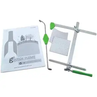

Commercial products
There are several commercial products that can do this as well if you are more comfortable.
Small apparatus that you can buy
In use it would look like this.
I have glass cutting experience but have never used a product like that. Videos of them used look very promising though if you are willing to spend the money.

  • I used to have a commercial one. This too produces irregular cuts, so don't think just because it cost more it'll be better! I use the candle/ice technique. – Mark Williams May 24 '16 at 12:37
  • @MarkWilliams This might come down to tool quality, handling and the bottle used. I have watched videos of that tool done very well with clean cuts. There is no one answer to this question though. – Matt May 24 '16 at 12:52
