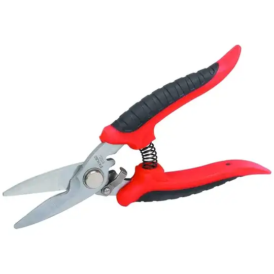

    Turns out a pair of scissors was all I needed. I was worried it would ruin them so I used an old pair and no problem because the sheet is so thin. Made for cutting curves a lot easier than a utility knife. Didn't deform the metal either. Then I used a sanding bit on my Dremel to deburr the edges. Not smooth by any means but no jagged bits and it took off the sharp edge. – dugost Oct 24 '17 at 13:53
For material that thin, even a set of heavy duty scissors will work well enough. Harbor Freight sells stainless steel multipurpose scissors for six bucks US that should do well enough for 0.0125" stock.
HF scissors
