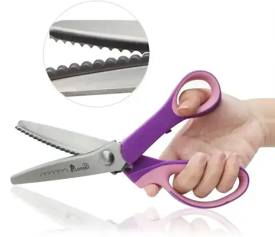

I popped out a 'net search using "scalloped edge shears" and found a variety of sewing related cutters that may work, if your material is thin enough.
The first link I selected, from Amazon, has a user question regarding the size of the scallop. It's 5 millimeters, although there are others with 3 and 7 mm sizes according to my search results.
It's important to note that the edge on the downstroke will probably have a bit of a burr, but one can remove the burr with a few strokes of abrasive material such as sandpaper. The shears will not last long cutting aluminum, but may provide for a few hundred cuts before needing replacement.
scallop shears image
It's important to note that you'll have to carefully align a 5 mm wide strip with a 5 mm wide cut to ensure you get a smooth profile. It might be more practical (easier) to use a 7 mm scallop to provide a bit of leeway.
A jig of sorts holding one handle of the shears braced against a surface, along with a guide channel to place the material consistently will facilitate production.

    Not bad in theory, but having used these, they're way too flimsy to cut wires – Allison C Mar 26 '20 at 13:37
  • I never tried these, but your suggestion got us seriously thinking about trying out "flimsy" tools, which led to actually trying a pair of toenail clippers, which actually worked well. – Christopher Bottoms Jan 05 '21 at 01:42
  • The model above probably won't work for long. But you do get more heavy duty pinking shears that are used by furniture upholsterers rather than dress makers. The pair I use belonged to my grandmother and has during its 50+ years of life been used to cut leather, plastic and sheet metal, strip wire, remove nails from wood ... when it needs honing, we just cut a few sheets of aluminium foil and it's sharp and ready to go again. – Gwyn Jan 06 '21 at 20:15
