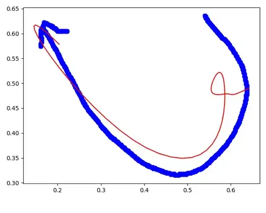

I have a set of unordered points that I'm getting from an image attached. I'd like to simply fit a parametrized curve such as a catmull-rom curve to with n control points (n = 4 to 10, and can be assumed to be known).
I've explored ways of doing this and it seems there doesn't seem to be some library function that simply does this. I explore b-spline fitting (as I read that it's possible to convert b-spline to catmull-rom afterwards) with scipy that simply seems to unable to fit this properly.
import scipy.interpolate as interpolate
tck, u = interpolate.splprep([x, y], s=6)
N = 100
xmin, xmax = 0, 1.01
unew = np.linspace(xmin, xmax, N)
spline = interpolate.splev(unew, tck)
plt.plot(x, y, 'bo', label='Original points')
plt.plot(spline[0], spline[1], 'r', label='BSpline')
plt.show()
I'm now thinking of doing a robust regression approach now (https://scipy-cookbook.readthedocs.io/items/robust_regression.html). But, I'm lost on how to convert my set of [x, y] points to a parametric formulation for catmull-rom spline to write the loss function needed for least squares fit.

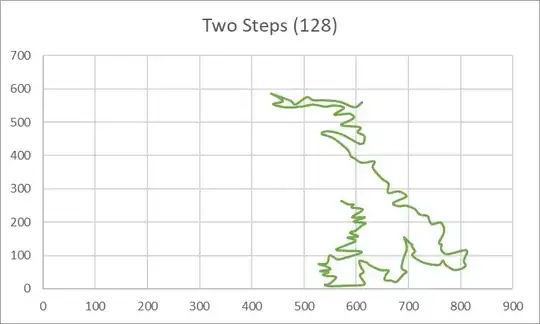

The above has been run on the outline on a section of a map (a section of a fjord apparently) which I've plotted using Excel's scatter plot tools (which I hope will give a 'reasonable' approximation of Catmull-Rom splines without me having to write (or find) my own rendering code)
This shows an original set of 512 points: enter image description here
..the set of 256 low-frequency points obtained from one wavelet step... One Wavelet Step
...through to the 128 points obtained by two steps:enter image description here

  • Given that the initial end points aren't really being handled correctly in the above, I'm not sure just 4 points would be terribly useful. The plot with just 4 (and also 8 points) looks like the outline of a nose! :-/. I might need to fix the example code. – Simon F Oct 08 '19 at 16:21
