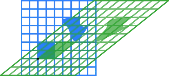

This 2D transformation is so important that it has a name: shear transformation.
It is cool to visualize this transformation:
Image source.
Note how every horizontal line (fixed y) is just translated (larger y being translated more).
We just happened to take the line y = 1 as our new 1D line, and translate it with a 2D matrix.
