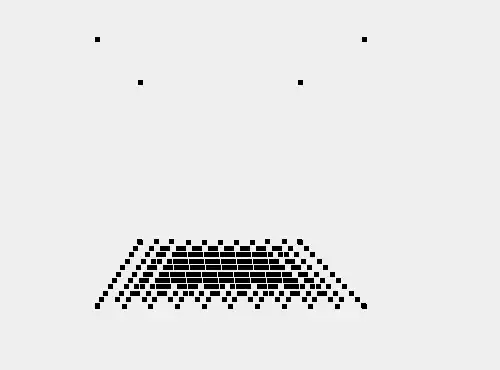

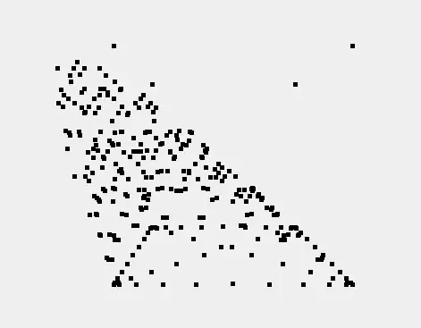

With cosine interpolation
Error. As you can see, there is some weird problem : face's points are inclined towards left.
