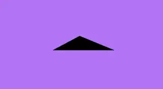

When I try to import and to render this data using gl.drawElements(gl.TRIANGLES, 72, gl.UNSIGNED_SHORT, 0); I get the following output:
ERROR :GL_INVALID_OPERATION : glDrawElements: attempt to access out of range vertices in attribute 1
If I use above (.obj) vertex and normal data six time each I do not get any more errors but instead of a cube only a single triangle seems to be rendered.
I am pretty sure that attribute 1 is in vec3 a_normal; in my vertex shader. So I am mainly confused about one thing here:
  • How do I modify my code in order to interpret and render the data correctly?
EDIT:
After changing indices to be zero based I do get more than a single triangle, the object still looks wrong.
The result drawn with gl.LINES:

    @DanHulme Done, I edited the question part to ask for help to modify the code in order to interpret the wavefront data correctly. I also subtracted 1 from every index in the file. This did change the rendered mesh, it is still not a cube though. Any help would be appreciated. – チーズパン Jan 06 '18 at 10:56
