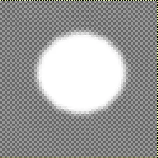

And if I set the transparent pixels to #00FFFFFF, I'll get this (this is the intended IF the blurred color is white)
Intended result

As it turned out, I forgot to weight the color channel by the transparency, so I got the same issue as written here: Blur Transparency Bug
