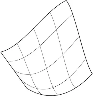

Now this is not actually the original reason, only it happened in roundabout way. The original reason what that the geometrical patches that they did use a as parametric primitives are square in shape. As extending a line into a surface naturally takes a square shape if you just extrude out. Having a triangle causes one edge to be degenerate and have a singularity. But this is very much related to the subdividing reason as it can be shown that a subdivision surface is just a general case of a spline patch.
Image 2: Original parametric surfaces were extensions of curves, not arbitrary meshes and these shapes naturally tend to be square.
