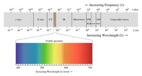

Visible light spectrum and RGB projection
Visible light spectrum contains “infinite” number of electromagnetic wavelengths from ~390nm to ~730nm. enter image description here
The power spectrum emitted by light is defined with SPD (in W/m^2/nm) and you can calculate the “HVS neutral” physical light intensity, i.e. Radiant Exitance $M_e$ (in W/m^2) by integrating the spectrum over the visible light range: $$M_e=\int_{390}^{730} S(\lambda)d\lambda$$ However, RGB color space is defined in photometric units by projecting SPD using HVS weighted color matching functions. This projection is done because storing SPD would consume immense amount of memory for little gain for image visualization purposes. The projection of SPD to RGB is defined with integrals over the visible light range as follows: $$R=\int_{390}^{730} S(\lambda)\bar{r}(\lambda)d\lambda$$ $$G=\int_{390}^{730} S(\lambda)\bar{g}(\lambda)d\lambda$$ $$B=\int_{390}^{730} S(\lambda)\bar{b}(\lambda)d\lambda$$ CIE 1931 defines standard observer RGB color matching functions as shown below, based on measurement of 10 human observers
As you can see the functions are not discrete wavelengths for RGB, but rather weighted averages of (overlapping) wavelengths.
It’s not possible to unambiguously calculate Radiant Exitance from RGB values because many different SPD's may resulting different Radiant Exitance but project to the same RGB. This is called metamerism.
