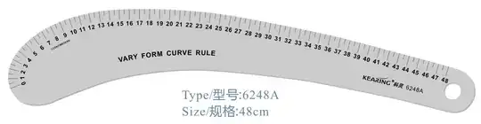

However, I am not sure how to approach the problem of curve fitting. Ideally, the user would be able to have curves in the cad file fit (probably approximated) so that they may draft them using standard French curve forms, including:
Hip Curve
Vary form curve
Assume that these curves are made to standard shapes and sizes and are modeled with dimensional accuracy. Furthermore, they are ruled at specific points and a user can place them on the paper diagram at specific positions and angles (relative to the other elements in the diagram that have already been drafted).

As far as I know, there are no standard shapes for (physical) French curves. The folks who manufacture them are free to choose any shapes they like. Of course, they choose shapes that look "nice", which typically means curvature that's either monotonely increasing or has a single peak value.
So, you can't solve this problem unless you make some assumptions about the specific shapes of French curves available to your user(s).
Once you have done this, you can model the shape of the French curve as a Bezier curve (for example). Then the problem is to position/orient this Bezier curve so that it fits the data, which is a simple least-squares fitting problem. I'll provide more details if you confirm that this approach is promising.
