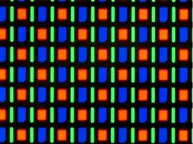

Although the difference may not especially noticeable, I would expect sampling taking into account the exact pixel geometry to give a slightly more accurate image. You just need to offset your pixel centres per colour component according to the (average) location of the subpixel(s) of that colour. Note that not all pixel layouts have a one to one correspondence between pixels and sub pixels.
For example, penTile RGBG has twice as many green subpixels as red and blue, as this image from Wikipedia shows:
Close up image of RGBG pixel geometry
I am not aware of any technical reason that would prevent this being used to produce arbitrary full colour images. In fact a colourful scene will have less noticeable colour artefacts than black on white text, which makes the colour differences hardest to camouflage.
