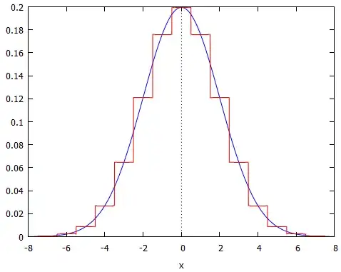

For more complex graphing tasks that involve a bit of programming, I use Maxima, a free computer algebra system that also has graphing features. I used Maxima to create the graphs in this answer about Gaussian blurs:
This was a bit too complex for Desmos, since it involved programmatically creating a piecewise approximation of a Gaussian.

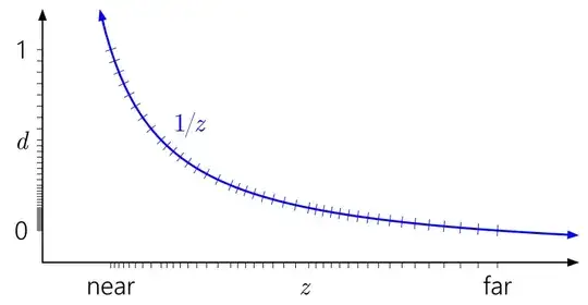

For really odd graphing tasks that aren't handled well by anything else, I've used Python with the svgwrite package to programmatically generate diagrams into .svg files. These can then be touched up in Inkscape if desired and rendered to bitmaps using Inkscape or ImageMagick. I used that workflow to create the images in this blog post on depth precision, like this:
In this case I wanted to not only graph a function, but place tick marks programmatically and nonuniformly along both the axes and the graph, to illustrate discrete depth buffer values.

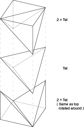

tetra image
Image 3: Sometimes its easier to start from scratch in postscript. Image added to post on ENG.SE.
Finally a image that really is easier to do by typing the values in postscript. It is relatively easy to do in postscript. Ive still done the typography in illustrator. While drawing this by hand is not a big deal i prefer not to, but i will do it if i must do judgement call by eye.

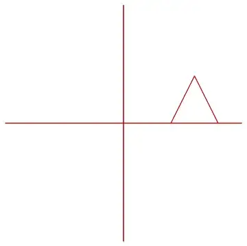

Mathematica
Mathematica is wonderful if you want to explore things a bit more. The only drawback to Mathematica is that it is NOT cheap. But it can do nearly anything quickly. Ive used Mathematica for some of my pictures on of nurbs basis.
One of Mathematicas core competencies s that its easy to develop even fairly complex pictures without much hassle. It can also easily animate your simple picture within you editor.
Graphics[{
    orig = {
        Table[
            GeometricTransformation[
                Line[{{0, 0}, {50, 0}}],
            RotationTransform[ang]],
            {ang, 0, 3 Pi/2, Pi/2}
        Line[{{20, 0}, {30, 20}, {40, 0}}]
    Red,
        orig,
        RotationTransform[Pi/6]
Results in same picture as others have. Wrapping it inside a table as per results in:
Image 4: Animation is simple to do inside the code editor using Mathematica.

  • For the PS image, is that an isomorphic projection? Did you calculate the values by hand or do you have a function to do projections? – luser droog May 08 '20 at 23:10
  • @luserdroog i have a function that takes a 3D coorinate and projects it yes. Basizally its a isometrix matrix plus a offset move for z. Why? You need something like that? – joojaa May 09 '20 at 09:28

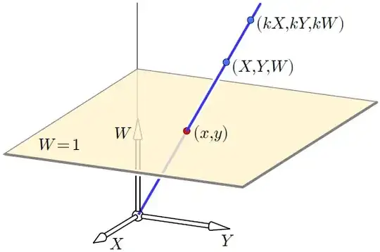

I just use Powerpoint to make such diagrams and it works great as soon as you're comfortable with its basic primitives. It supports all simple operations like rotation, translation, etc. and recent revisions also have shear and 3D transforms. Examples:
Here is an example of a Powerpoint diagram I made for an answer.
For more complicated diagrams, especially in 3D, I sometimes use Blender with shadeless materials. I can elaborate and show examples if it is relevant to your question.

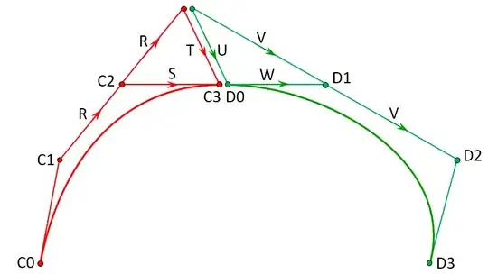

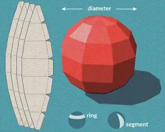

I use Powerpoint and various (expensive) CAD packages. I wrote Powerpoint macros (VBA code) to do some special things like draw the control polygons of Bezier curves. Then I use the standard Windows Snipping Tool to grab screen shots. Here are some examples:
And some further examples from Math.SE
One
Two
Three
Four
Five
