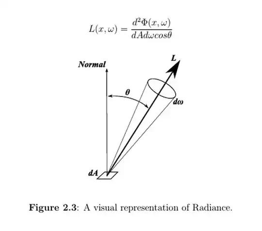

What one has to do in this matter is first define the quantities that are physically at play here, so that everybody speaks about the same thing.
There is:
  • radiance (wikipedia)
    Flux emitted by a surface per solid angle per projected area.
    Unit is W·sr−1·m−2
  • radiant intensity (wikipedia)
    Origin of radiance, you take the surface area out of the unit.
    Unit is W·sr−1
  • intensity (wikipedia)
    A perception-based unit of power per solid angle.
    Unit is candela
  • luminance (wikipedia)
    The luminance is normally obtained by dividing the luminous intensity by the light source area (source)
    therefore this is also perception based.
    Unit is cd·m−2
  • luminuous flux (wikipedia)
    Same thing but not related to solid angle.
    quote:
    Luminous flux is a measure of the total amount of light a lamp puts out. The luminous intensity (in candelas) is a measure of how bright the beam in a particular direction is
    Unit is lumen
You can also talk of irradiance (wiki) when speaking of received radiance.
And one can also talk of total-irradiance when speaking of the irradiance taken for the whole hemisphere.
refer to: http://www.crompton.com/light/index.html
and: https://pathtracing.wordpress.com/
and why not: http://www.nvc-lighting.com/showuseInfo.Aspx?typeID=42&ID=94
As you can see, there are two classes of units, the perception based and the absolute physical units.
the radiance is the measure you want to look at to understand Lambert, you can actually see the cosine falloff directly in the formula.
You can see the intuition of this in this blog: https://pathtracing.wordpress.com/ chapter "Lambert's cosine law"
