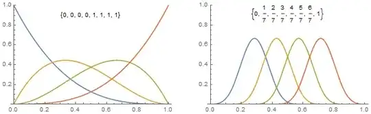

Ok so what are the knots? They are simply the ranges of the basis functions. Since the cubic b-spline with 4 points has 4 interpolating functions it needs 8 knots. Only areas where 3 functions overlap and sum up to 1.0 can a line be drawn.
Image 5: 2 different basis functions, a bezier like and a uniform segment parametrisation, spread to 0-1 range.
And now we have mostly described the answer to question 1. The range is not defined you can stretch the basis functions as you see fit. And finally the knot vector simply produces the parameter ranges for the basis functions. Theres still one more thing that governs the shape of the curve and that is the weight vector. But that another story to be told elsewhere.
