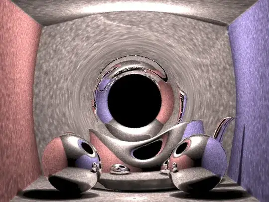

Here's a scene I rendered a while ago using a homebrew photonmapper (no QMC) using this raymarching technique.
I present: relativistic photon mapping: black hole in a Cornell box! black hole in a Cornell box
