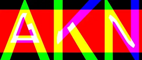

Now of course, the question is, how do I build such a three-channel distance field? And this is the tricky part. The most obvious approach that I took in the beginning was to perform a decomposition of the input shape/glyph into three components, and then generate a conventional distance field out of each. The rules for this decomposition aren't that complicated. Firstly , the area with at least 2 out of 3 channels on is the inside. Then, if you imagine this as the RGB color channels, convex corners must be made of a secondary color, and its two primary components continue outward. Concave corners are the inverse: Two secondary colors enclose their common primary color, and the wedge between where both edges continue inward is white. I also found that some padding is necessary where two primary or two secondary colors would otherwise touch to avoid artifacts (for example, in the middle stroke of the "N" in the picture).
The following image is an example decomposition generated by the program from my thesis:
Multi-channel decomposition of glyphs

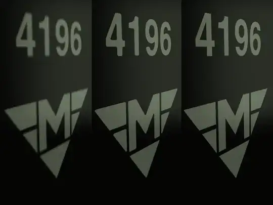

Anyway, here is an example of the difference in quality. The texture resolution is the same in each image, but the left one uses a regular texture, the middle one uses an ordinary distance field, and the right one uses my three-channel distance field. The performance overhead is only the difference between sampling an RGB texture versus a monochrome one.
