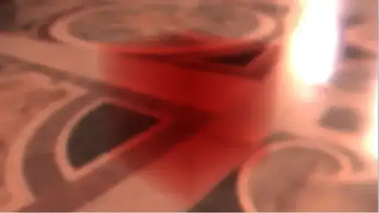

When I implement Beer's law (color absorption over distance through an object), it never looks very good for some reason.
When i have the color behind the object, I calculate the adjusted color like this:
const vec3 c_absorb = vec3(0.2,1.8,1.8);
vec3 absorb = exp(-c_absorb * (distanceInObject));
behindColor *= absorb;

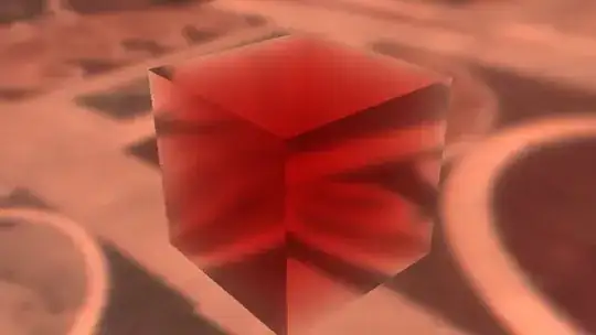

That will give me something that looks like this (note a little bit of refraction applied): enter image description here
And here it is without refraction: enter image description here
Note that this is implemented as a shader toy here.

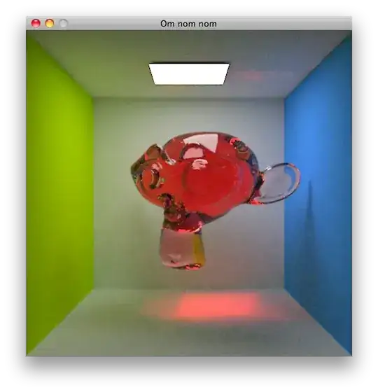

That fulfills the description of what Beer's law does, but it doesn't look very good, not when compared to shots like this: enter image description here
Specular highlights aside, I'm trying to figure out the difference. Could it just be that my geometry is too simple to really show it off very well? Or am I implementing it incorrectly?

    You're comparing a cube with a more complex mesh however. Why not replicate the same scenario? The Susan model is easy to get. – Bart Aug 20 '15 at 15:15
  • It's not so easy in a shadertoy implementation! (: – Alan Wolfe Aug 20 '15 at 15:16
    You cube looks correct to me: Get more transparent as it approaches the edges. If you can do full blown Suzanne the a sphere should at least give a better approximation of the look in the other picture. – yuriks Aug 20 '15 at 15:51
  • ok fair enough. i'll try it with better geometry, but i think you are right. I'll accept it if you make an aswer! – Alan Wolfe Aug 20 '15 at 16:37
    I can't separate the refraction from the attenuation. Can you render the cube with IOR=1.0 please? – geometrian Sep 01 '15 at 16:19
  • added imallett, also linked to the shadertoy – Alan Wolfe Sep 01 '15 at 16:26
    @AlanWolfe Your IOR=1 render looks exactly as I would expect it, and I skimmed the shadertoy impl and it looks good. – geometrian Sep 02 '15 at 01:26
  • The path tracing example at the bottom is simulating total internal reflection also which adds a lot of complexity to the shading. Thin areas can appear both 'thicker' and more attenuated like the rims of the ears for example. – PaulHK May 19 '17 at 07:38

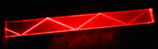

In reality, When light enters glass from air, it often does not immediately exit the glass. This is because when the light strikes the glass/air interface, a phenomenon known as total internal reflection (TIR) can occur. TIR occurs when light travels from a medium with a higher index of refraction (IOR) to one with a lower IOR, which is precisely what happens in the case of light hitting the interior wall of a glass object. This image from Wikipedia is a good visual demonstration of what it looks like when it occurs:

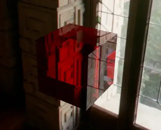

In basic terms, what it means is that if the light hits at a shallow angle, the light will completely reflect off of the interior of the medium. To account for this, you need to evaluate the Fresnel equations every time that your light ray hits a glass/air interface (AKA the interior surface of your mesh). The Fresnel equations will tell you the ratio of reflected light to the amount of refracted light, while will be 1 in the case of TIR. You can then compute the appropriate reflected and refracted light directions, and continue to trace the light's path either through the medium or outside of it. If you assume a simple convex mesh with a uniform scattering coefficient, then the the distance to use for Beer's law will be the sum of all internal path lengths before exiting the medium. Here is what a cube looks like with your scattering coefficients and IOR of 1.526 (soda lime glass), rendered using my own path tracer that accounts for both internal and external reflections and refractions:
path-traced glass cube
