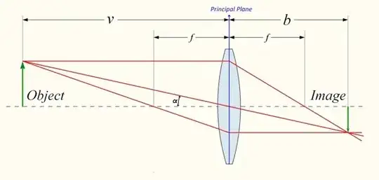

The next step up from a pinhole camera model is a thin lens model, where we model the lens as being an infinitely thin disc. This is still an idealization that pretty far from modeling a real camera, but it will give you basic depth of field effects.
Thin lens model
The image above, from panohelp.com, shows the basic idea. For each point on the image, there are multiple rays arriving at that image point, via every point on the 2D lens surface. Therefore, generating an image like this using Monte Carlo will require picking, for each ray, both a 2D sample point on the image plane and an independent 2D sample point on the lens surface.
The user-facing parameters to set will be the lens radius (as a physical radius in scene units), which controls how shallow the focus range is (larger lens = shallower focus range), and the distance at which you want objects to be in focus.
To generate eye rays into the scene, you can calculate the position and direction of rays leaving the lens surface; in this model there's no need to explicitly simulate the image plane and the refraction through the lens. Basically, think of the lens as centered at the camera position and oriented to face the camera direction.
Based on the image location, construct a ray from the camera position (lens center) into the scene, just as you would in the pinhole model; then find its intersection with the focal plane. That's where all the rays from that image location should converge. Now you can offset the starting point of the ray to a randomly chosen point on the lens, and set its direction to be toward the convergence point.
