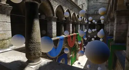

This screenshot from Simon's Tech Blog shows an array of SH light probes spaced throughout a scene, each one showing the indirect lighting received at that point:
SH light probe array

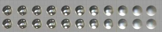

The other currently common meaning of "light probe" is an environment cube-map whose mip levels have been pre-blurred to different extends so it can be used for specular lighting with varying levels of roughness. This image from Seb Lagarde's blog shows the basic idea:
Prefiltered cubemap mip levels
The higher-resolution mips (toward the left) are used for highly polished surfaces where you need a detailed reflected image. Toward the right, the lower-res mip levels are increasingly blurred, and are used for reflections from rougher surfaces. In a shader, when sampling this cubemap, you can calculate your requested mip level based on the material roughness, and take advantage of the trilinear filtering hardware.

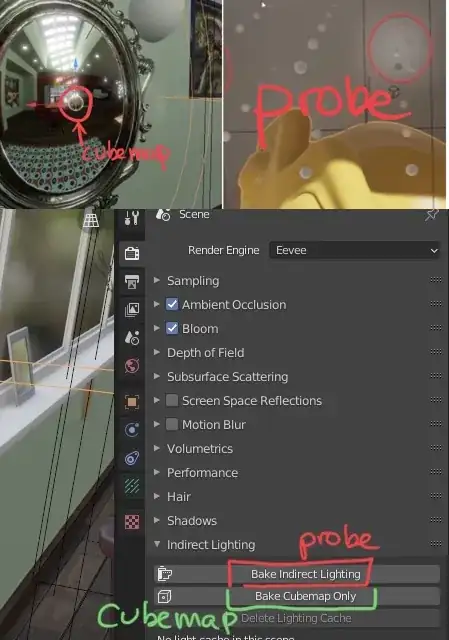

probe vs cubemap in blender
the cubemaps which have this cube shape in blender store a 360 image of that point that can be used for reflections, world texture images...
also seems like cubemap can be called reflection probe sometimes to add to the confussion, so seems like cubemaps are a type of probe too more specific to remapping
probes which are the circles store only light info (am i getting white raylights? yellow?)
I might be wrong, in that case correct me
