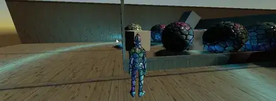

In my torus light implementation(Unity3D) I use the same real-time method described in @JohnCalsbeek's answer. Just treat it the same way you treat your regular point/spot light and calculate a single direction and distance.
I use the torus distance equation from Inigo Quilez's site and here's the function I made to get the direction to a torus
float3 torusDirection(float3 p) {
float3 torusRel;
torusRel.xz = normalize(p.xz-_TorusLocation.xz);
torusRel.y = 0;
return -normalize(p-(TorusLocation+torusRel*TorusCenterRadius));
Overall I think it works well minus a few areas that look off where the torus loops around .
The specular hint is also off but @JohnCalsbeek's point of modifying the roughness seems like it should fix that :).
The hardest challenge for me with the light right now is making a forward shader that supports different kinds of area lights and multiple lights. I don't know how I would do this besides just having a whole bunch of shader properties for all the different lights though. Currently I apply the light as a deferred pass so it only works with opaque objects but soon I'll need to make a forward version for transparent objects. That's the real challenge I think, getting multiple area lights in a forward shader.
