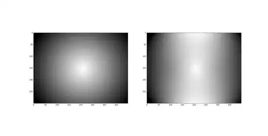

Here's an example on how to do this with Python, Numpy and Matplotlib. Image on the right has been averaged (row by row), while the left is the original.
EDITED: As suggested by @Nathan Reed, I avoided flipping colors when row average is 0. Rows with an average of 0 now get a value of 0.5 (128). The dark image encountered previously was due to values higher than 1 (255) due to scaling, that were represented as white in matplotlib's image renderer. I fixed this by setting the max value in any pixel to be 1.

Here's another test with a simple gradient image (left is the original):

2Something looks wrong with your first image pair...the result is mostly complete black, which doesn't seem correct. Also, it would be good to handle divide-by-zero so rows that are complete black in the input don't flip out. Maybe just replace the row by all 128s in that case? – Nathan Reed Dec 24 '15 at 21:30
Same algorithm for 1st and 2nd img. Will check though, makes sense about the flipping, thanks. – TLousky Dec 24 '15 at 22:20
The above solution seems correct at first glance but what if user enter the output image as input then it shows distorted output. The solution should be adaptive and learn when not to perform calculation as the output of first input is the solution so when output is again input no changes should be seen. – Sandiip Jan 01 '16 at 07:45
@SandeepNeupane that makes sense, although that's not what the author of the question asked. I'm sure this answer can serve as the basis for a more adaptive, complete solution. – TLousky Jan 01 '16 at 18:16
