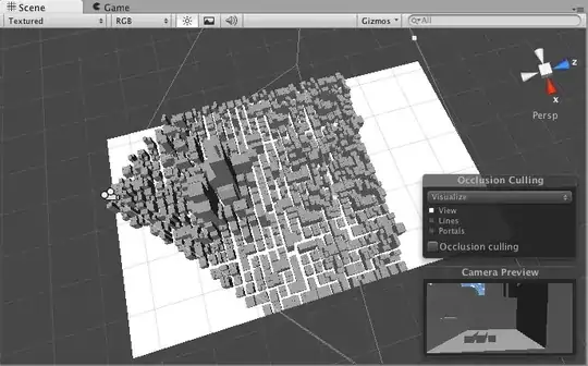

  • Check if a certain part of the scene is in my view frustum
    Frustum Culling

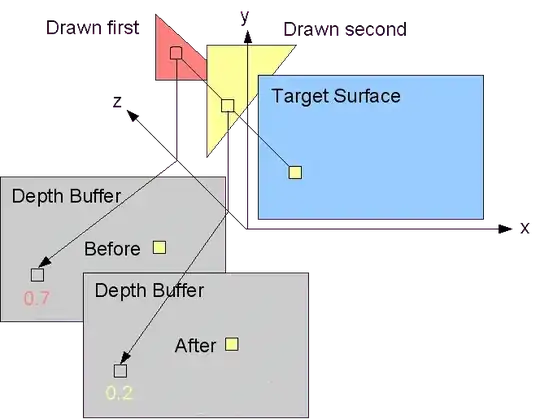

  • Check if something is in front of it which may needs to be rendered later using a depth buffer
    Depth Buffer

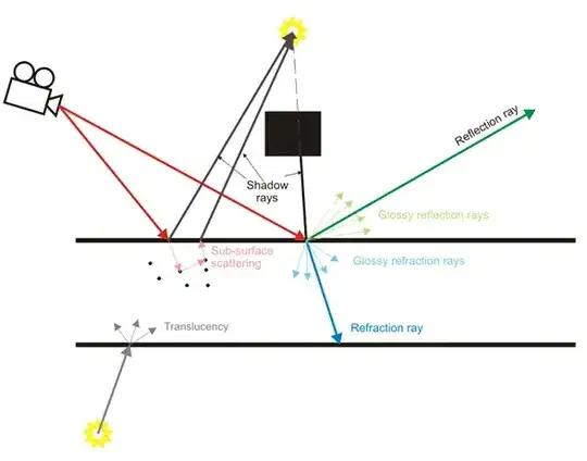

Instead of only checking if a point is hit, most raytracer now begins to calculate:
  • the amount of light a surface penetrates
  • how much light gets reflected
  • cast new rays from the hitpoint into the scene until it may hit a light source
There are a ton of techniques with different degrees of realism which can be used to calculate the light of a certain point in the scene.
