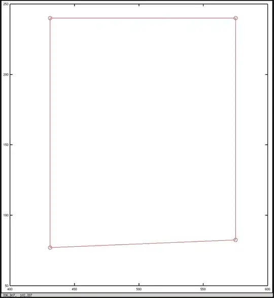

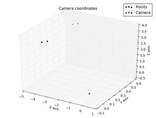

And these are the plots I've got from the script: I was expecting they were somewhat similar, but they don't look so.
3D plot
Plot in camera coordinates
2D plot
Plot in image coordinates

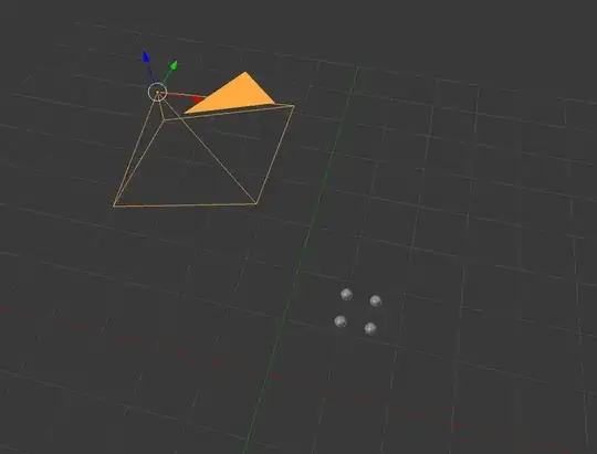

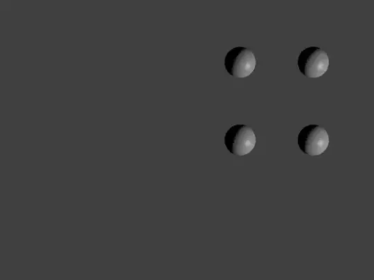

A good way to check your answer is by using an existing 3D modeler like Blender: 3D scene in Blender Be cautious with Blender' coordinates system, for example the default camera vector is [0, 0, -1]. Here's the render: Render in Blender Focal was set to another value to make the sphere more visible. So we see that the bottom two points are on the middle row of the image and the points are slightly to the right of the image.

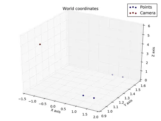

I implemented your homework in Python:
import numpy as np
from matplotlib import pyplot as plt
from mpl_toolkits.mplot3d import axes3d, Axes3D
# Parameters
f_mm = 0.016
f_px = f_mm / 0.00001
t_cam = np.array([[-1., 1., 5.]]).T
t_cam_homogeneous = np.vstack((t_cam, np.array([[0]])))
theta = 160. * np.pi / 180.
ox = 320
oy = 240
# Rotation and points are in homogeneous coordinates
rot_cam = np.array([[np.cos(theta), 0, np.sin(theta)],
                    [0, 1, 0],
                    [-np.sin(theta), 0, np.cos(theta)]])
points = np.array([[1, 1, 0.5, 1],
                   [1, 1.5, 0.5, 1],
                   [1.5, 1.5, 0.5, 1],
                   [1.5, 1, 0.5, 1]]).T
# Compute projection matrix using intrinsics and extrinsics
intrinsics = np.array([[f_px, 0, ox],
                       [0, f_px, oy],
                       [0, 0, 1]])
extrinsics = np.hstack((rot_cam, rot_cam.dot(-t_cam)))
rot_cam2 = np.identity(4); rot_cam2[:3,:3] = rot_cam
camera_coordinates = rot_cam2.dot(points - t_cam_homogeneous)
camera_coordinates = camera_coordinates[:3,:] / camera_coordinates[3,:]
# Perform the projection
projected_points = intrinsics.dot(camera_coordinates)
projected_points = projected_points[:2,:] / projected_points[2,:]
projected_points[0,:] = -projected_points[0,:] # Inverted x-axis because camera is pointing toward [0, 0, 1]
fig = plt.figure()
ax = Axes3D(fig)
ax.scatter(points[0,:], points[1,:], points[2,:], label="Points")
ax.scatter(t_cam[0], t_cam[1], t_cam[2], c="red", label="Camera")
ax.set_xlabel("X axis"); ax.set_ylabel("Y axis"); ax.set_zlabel("Z axis")
plt.title("World coordinates")
plt.legend()
plt.savefig('world_coordinates.png', dpi=300, bbox_inches="tight")
fig = plt.figure()
ax = Axes3D(fig)
ax.scatter(camera_coordinates[0,:], camera_coordinates[1,:], camera_coordinates[2,:], label="Points")
ax.scatter(0, 0, 0, c="red", label="Camera")
plt.title("Camera coordinates")
plt.legend()
plt.savefig('camera_coordinates.png', dpi=300, bbox_inches="tight")
plt.figure()
plt.scatter(projected_points[0,:], projected_points[1,:])
plt.xlabel("X axis"); plt.ylabel("Y axis")
plt.title("Image coordinates")
plt.savefig('image_coordinates.png', dpi=300, bbox_inches="tight")
plt.show()

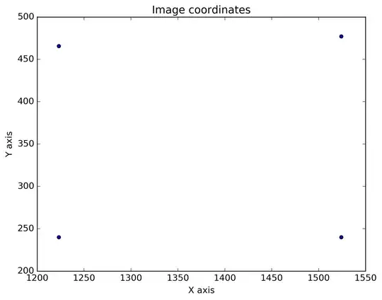

This yield me those figures: World coordinates Camera coordinates Camera coordinates rotated Image coordinates Respectively: World coordinates, Camera coordinates, Camera coordinates rotated to fit slightly the camera orientation (note that here the camera vector goes toward the figure viewpoint, it does not "enter" the figure) and image coordinates.
So we see that the vertical coordinates for the bottom points are correctly on the middle row (240) and the points are on the right side of the image (horizontal value > 320).
I believe one bug you had is that you found negative X values, so you negated the focals (-f/Sxy) in the intrinsics matrix to compensate. The issue here is that we've assumed that the camera initially was pointing toward $[0, 0, 1]$ (otherwise the 160° rotation would not point toward the points). If you look at it that way, the $x$-axis increases when going toward the left, the inverse of this axis should be taken.
Both our results seems similar to me, just that you supposed a $[0, -1, 0]$ up vector for the camera (in fact both axes were mirrored because you negated both focals), and did the computation in mm instead of meters.
