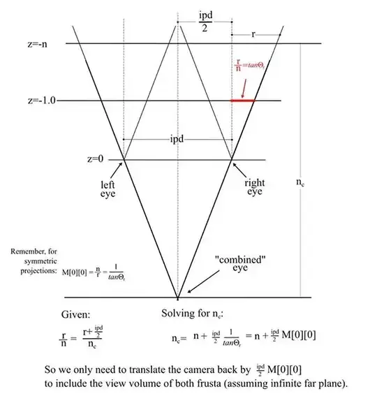

When rendering VR ( stereo view ) environments, do you guys recommend just doing 2 frustum checks for determining what is to be drawn during the frustum culling pass or is there some other check that would be able to combine both frusta?
3 Answers
It's pretty easy to create a single frustum that encloses both of the individual eye frusta, as shown in this diagram created by Cass Everitt at Oculus. You just have to place the vertex of this frustum between the eyes and behind them a little bit. You can also increase the near plane distance to match the original near plane of the eye frusta.
Such a frustum includes a little space that wasn't in the union of the original two frusta. There's a small volume horizontally between the two eyes; also, the diagram doesn't show the vertical dimension, but pulling the frustum vertex back makes it include some space above and below the original frusta. However, for practical culling purposes it probably doesn't matter. Frustum culling is usually conservative anyway, and the extra space is only a few centimeters in thickness.
It's also possible to simply cull against the original frustum top and bottom planes (which are shared between eyes) together with the outer side planes. These planes don't form a frustum, technically, but if using "the usual" culling algorithm that tests against one plane at a time, the algorithm will happily work on any set of planes you care to give it.
Sharing frustum culling, LOD selection, etc. between eyes, rather than re-doing it twice every frame, is a great way to optimize the CPU cost of stereo rendering. This is also a prerequisite if you want to use a rendering method that draws both eyes in a single pass, such as instanced stereo rendering.

2Thanks Nathan that's exactly what I was after, where did you get this diagram may I ask, is it in any public documentation from oculus ? – Garry Wallis Nov 19 '15 at 05:34
2@GarryWallis Cass tweeted it a few months ago. – Nathan Reed Nov 19 '15 at 05:37

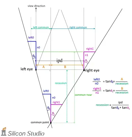

I've generalized Everitt's results if that's needed.
As a bonus, a way to extract left0/right0 from the eyes perspective matrices:
left0 = n0 * (Mle13 - 1) / Mle11;
right1 = n1 * (Mre13 + 1) / Mre11;
If you have row major. transpose for column major. c.f. this answer
