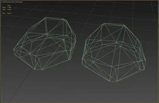

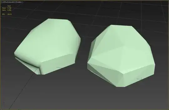

I am trying to understand why meshes that are smoothed in 3D studio (Modifiers/Smoother) end up having the same amount of vertices/faces before or after that process, as well as the exact same geometry.
In the following example, both meshes have 32 vertices and 60 faces.
Although I have experience working with programming (c++ and c#), I am quite a beginner with computer graphics. Thus my expectation was that the smoothed look of a smoothed mesh would require additional vertices, i.e. subdivision of triangles, in order to end up having a more detailed final mesh. However, that seems to be not the case.
Therefore I ask:
1) how is the smoothing possible without increasing the detailing of the mesh geometry?
2) does the smoothing at least increase the memory allocated/used for storing the new mesh in comparison to the original one?
Explanations are super welcome, but references (academic or not) are also appreciated.

Smooth in this case just makes the surface normals at vertices point the same way, when interpolated it looks smooth. Meshsmooth would add vertices.
Human eyes cant actually see curvature except on the edges of objects. All they can do is approximate the smoothness and process the gradient slope. So having a continuous field does give a air of smoothness. The eye however is extremely sensitive to abrupt changes in color, and interprets that as a hard crease.
By interpolating the vertex normals your surface will get the appearance of smooth flowing. Since this normal is used to calculate the final reflected color you get a smooth color field.

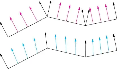

Flat shaded vs smooth shaded
Image 1: a flat shaded normal versus the normals of a smooth interplation. The black normal's lie on a vertex. The colored ones are interpolated.
