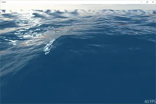

I'm trying to implement an ocean scene with C++ and DirectX11. Currently I have a projected grid, Gerstner waves and a basic shading. My problem is that when I aim my camera horizontally, so I can see the water horizon, in the distance, the projected grid becomes insufficient, even at high vertex numbers. These screenshots illustrate the problem:
shaded water surface

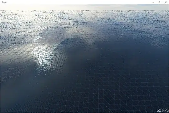

wireframe water surface
I know the cause of the problem is in the concept of the projected grid (the grid is detailed near the camera, rough far from it), but there has to be a best practice to solve this.
Any ideas?
I believe a common solution is to split the camera transform used to project the grid from the camera transform that is used to render the grid. At perspectives close to top-down, the two cameras coincide, but as the viewing camera gets close to a horizontal perspective, the projection camera deviates and tries to keep a minimum inclination, i.e. it hovers somewhere above the view camera and looks down slightly.
The tricky bit is making sure that the field of view of the projection camera always covers the region of the scene seen from the render camera. I don't have a resource at hand that details how to compute the appropriate transforms, and it might be tedious to derive by hand.
A different solution is to grab the signal processing toolbox: The artifacts seen in your image are essentially aliasing, caused by insufficient sampling of the wave heightfield by the projected grid. Therefore, one solution is to filter the heightfield appropriately, depending on the projected area of a grid cell. I believe this is used in offline rendering of oceans, and it essentially makes sure that waves at the horizon go flat. However, I'm not sure how feasible this is in real-time rendering, since you would need high-quality anisotropic filtering to make this approach look reasonable.
