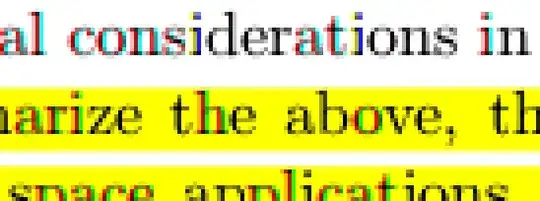

I recently had an issue with sub-pixel anti-aliasing of text, which produces very harsh colours and made me wonder how it is meant to be done properly:

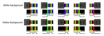

I've drawn some cases of a black tile covering thirds of pixels below.
The colours match the ones I'm seeing, however when I look at properly antialiased text, the result is not nearly as bright and distracting:
from www.lagom.nl
I assume there has to be a balance between a good light intensity and the right colour. What methods are used for sub-pixel anti-aliasing that give such good results?

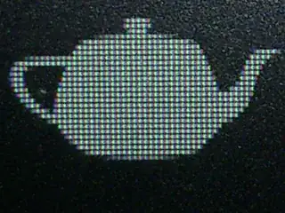

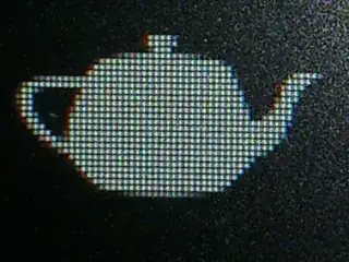

I've rendered a white teapot to an image with 3x width and with multisampling. Below I compare averaging every 3 pixels with assigning each to RGB. The colours still seem overly bright in some cases (especially compared to the example above from here), not that my phone captures them well.
enter image description hereenter image description here
enter image description hereenter image description here OK, so my monitor needs a little dusting

  • Hopefully someone with knowledge of this can confirm, but my guess is that the first image has been antialiased at the pixel level first, and then that antialiased image has been antialiased again at the subpixel level. You can see areas where the original antialiasing aligns with whole pixels and has no colour fringes, despite clearly having variations in brightness due to the initial antialiasing, and areas where it does not align resulting in flat colour fringes, rather than the graduated colour fringes in the last image. It appears to be a scaled rasterised font, rather than a vector font. – trichoplax is on Codidact now Aug 10 '15 at 10:30

I'm not sure what happens there. Looking at the rendering of "considerations" in your example, the "cons" looks like what you get when you do crude sub pixel anti-aliasing, without applying the necessary "fix up" to make it look good. But then the "der" in the same word looks like there's no sub-pixel anti-aliasing.
You can find a good article about how good looking sub-pixel anti-aliasing works here https://www.grc.com/ct/ctwhat.htm and for the "fix up" part here https://www.grc.com/ct/freeandclear.htm and here https://www.grc.com/ct/cttech.htm
What it comes down to is: if you just compute the R/G/B intensities by calculating the covered area for each sub-pixel, the resulting color fringes are very ugly/irritating. To fix it you have to apply a horizontal blur/low-pass filter to the sub-pixel image. The result is an image that's less sharp but also has far less saturated colors. I.e. something like your "Check you" example.

What the attached image goes, I don't believe it has anything to do with sub-pixel rendering. It could be anything: wrong pixel geometry, wrong gamma, wrong color space conversion, ...

  • I would expect problems with pixel geometry, gamma or colour space conversion to show up as colour distortion at arbitrary points in the image, rather than the regular cycle seen in the question's image. The fact that it cycles horizontally between exaggerated colour antialiasing and pure greyscale antialiasing hints that the first application of antialiasing was performed at a different scale. – trichoplax is on Codidact now Aug 10 '15 at 12:01
  • I don't have the full explanation, as the distortion does not seem to be aligned between the different rows of text, but it does seem the problem is related to sub-pixel rendering of already rasterised text rather than vector text. – trichoplax is on Codidact now Aug 10 '15 at 12:16
  • @trichoplax What I try to say is that I doubt there an issue with Anti-Grain's sub-pixel rendering. Instead I would guess the input gets mangled earlier than it enters the rasterizer. Or later, but not in the rasterizer itself. – Ecir Hana Aug 10 '15 at 12:39
  • Yes I think the sub-pixel rendering is being applied correctly, but when applied to pre-rasterised text it is not possible to give a good result. I don't think that the renderer is broken, I just think it is being fed the wrong kind of text. – trichoplax is on Codidact now Aug 10 '15 at 12:46
