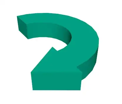

You simply dont want fully smooth results. While the commented method by Nathan Reed: "Calculate each vertex to face normal, sum them, normalize sum", generally works it sometimes fails spectacularly. But that is of no importance here, we can use that method by adding a rejection clause to it.
In this case you simply want certain parts not to be smoothed against certain other parts. You want selective hard edges. So for example the flat top and bottom is separate form the triangle strip on the side, as is each flat area.
Image we are after
Image 1: The result you want.
In effect you only want to average the vertices of the curved area all others can use the normal they get form their triangle alone. So you are better of thinking of the mesh as 9 separate regions that are handled without the others.
Showing mesh and normals]
Image 2: Image showing the mesh structure and the normals.
You can certainly automatically deduce this by not including normals that are outside certain angle from the primary vertexes normal. Pseudocode:
For vertex in faceVertex:
    normal = vertex.normal
    For adjVertex in adjacentVertices:
        if anglebetween(vertex.normal, adjVertex.normal )  < treshold:
            normal += adjVertex.normal
    normal = normalize(normal)
That works, but you can simply avoid all of this at creation time because you understand that separate planes are working differently. So only the curved sides need normal direction merging. And in fact you can just directly calulate them from the underlying mathematical shape.
