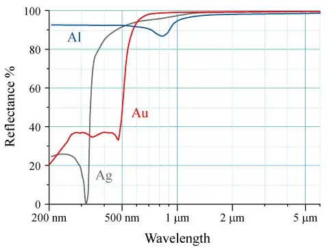

In addition, here is a reflectance curve from Wikipedia for some materials including gold (Au). The curve is certainly high for red wavelengths around 600nm but does not seem to go over 100%.
Reflectance (Au)

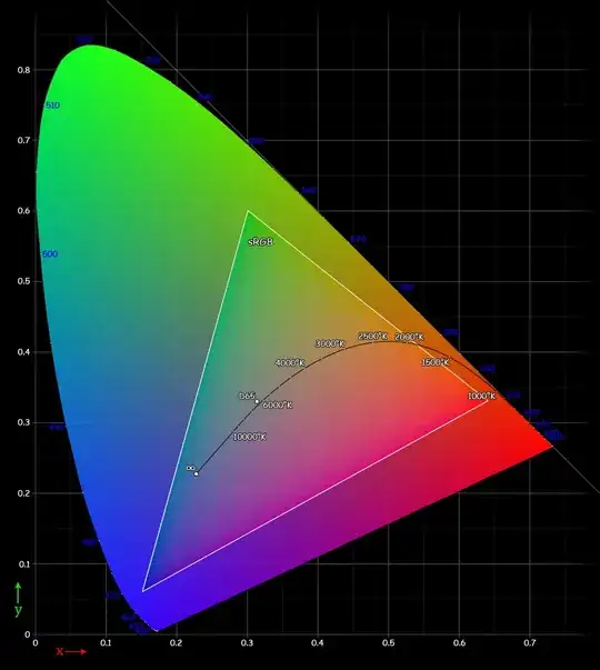

Here's a chromaticity diagram that includes a projection of the sRGB color space: a triangle whose vertices are red (1,0,0), green (0,1,0), and blue (0,0,1).
CIE chart with sRGB gamut from Wikipedia
Encoding the reflectance of a surface as the color at F0 and getting a value that is outside of the (somewhat arbitrary chosen) sRGB gamut is totally reasonable. It just means that gold is "more red" than sRGB can represent, because it reserves valuable area of its dynamic range for other colors.
