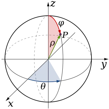

Assuming you mean a camera that rotates based on mouse movement:
One way to implement it is to keep track of the camera position and its rotation in space. Spherical coordinates happen to be convenient for this, since you can represent the angles directly.
Spherical Coordinates Image
float m_theta;
float m_phi;
float m_radius;
float3 m_target;
The camera is located at P which is defined by m_theta, m_phi, and m_radius. We can rotate and move freely wherever we want by changing those three values. However, we always look at, and rotate around, m_target. m_target is the local origin of the sphere. However, we are free to move this origin wherever we want in world space.
There are three main camera functions:
void Rotate(float dTheta, float dPhi);
void Zoom(float distance);
void Pan(float dx, float dy);
In their simplest forms, Rotate() and Zoom() are trivial. The just modify m_theta, m_phi, and m_radius respectively:
void Camera::Rotate(float dTheta, float dPhi) {
    m_theta += dTheta;
    m_phi += dPhi;
void Camera::Zoom(float distance) {
    m_radius -= distance;
Panning is a bit more complicated. A camera pan is defined as moving the camera to the left/right and/or up/down respective to the current camera view. The easiest way we can accomplish this is to convert our current camera view from spherical coordinates to cartesian coordinates. This will give us an up and right vectors.
void Camera::Pan(float dx, float dy) {
    float3 look = normalize(ToCartesian());
    float3 worldUp = float3(0.0f, 1.0f, 0.0f, 0.0f);
    float3 right = cross(look, worldUp);
    float3 up = cross(look, right);
    m_target = m_target + (right * dx) + (up * dy);
inline float3 ToCartesian() {
    float x = m_radius * sinf(m_phi) * sinf(m_theta);
    float y = m_radius * cosf(m_phi);
    float z = m_radius * sinf(m_phi) * cosf(m_theta);
    float w = 1.0f;
    return float3(x, y, z, w);
So, first, we convert our spherical coordinate system to cartesian to get our look vector. Next, we do the vector cross product with the world up vector, in order to get a right vector. This is a vector that points directly right of the camera view. Lastly, we do another vector cross product to get the camera up vector.
To finish the pan, we move m_target along the up and right vectors.
One question you might be asking is: Why convert between cartesian and spherical all the time (you will also have to convert in order to create the View matrix).
Good question. I too had this question and tried to exclusively use cartesian. You end up with problems with rotations. Since floating point operations are not exactly precise, multiple rotations end up accumulating errors, which corresponded to the camera slowly, and unintentionally rolling.
So, in the end, I stuck with spherical coordinates. In order to counter the extra calculations, I ended up caching the view matrix, and only calculate it when the camera moves.
