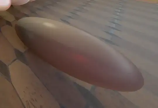

My intuition has always been that when any sphere is projected into 2D space that the result will always mathematically be an ellipse (or a circle in degenerate cases).
In the past when I was actively doing my own graphics programming and brought this up with other people they were adamant that I was wrong. If I recall correctly they believed the result could be something vaguely "egg shaped".
Who was correct?
Since there is already one answer submitted, I don't wish to totally change my question but I realize I left out important details due to losing familiarity with the field over the years.
I intended to ask specifically about perspective projection where the projection is a linear application.
The other projections are of course interesting for many uses so I wouldn't want them removed at this point. But it would be great if answers could have perspective projection as their most prominent section.

    Assuming a perspective projection, AFAICS the 'boundary' formed by the view-points horizon will be a (truncated) cone and thus most of the projection will be a conic section: https://en.wikipedia.org/wiki/Conic_section. An ellipse is thus a possibility, but not the only one. – Simon F Sep 15 '15 at 12:27
  • Pardon my naivety, isn't an ellipse a conic section? Could a projected sphere ever result in a parabola or hyperbola? – hippietrail Sep 15 '15 at 12:31
  • If you look at the wikipedia diagram, https://en.wikipedia.org/wiki/Conic_section#/media/File:Conic_Sections.svg, and consider the plane onto which you are projecting, you can get anything from an ellipse/circle, through to unbounded parabolas or hyperbolas (and I guess if the plane passes through the eye, even degenerate cases) – Simon F Sep 15 '15 at 12:35
  • Apologies! I omitted a key element of my question, that I was only concerned with perspective projection. I'm very rusty in this field and its terminology after many years away from it, yet I remain interested. By the way a [tag:perspective] would be a worthwhile addition to the site for questions such as this. – hippietrail Sep 15 '15 at 14:55
    In that case I will promote my comments to an answer... – Simon F Sep 15 '15 at 15:06
    you need to add a constraint. fisheye is also a perspective projection, and you won't get ellipses. the constraint you need is linearity. – v.oddou Sep 16 '15 at 01:16
  • @v.oddou: Thanks for your help with the terminology. Would that result in something like "projected into linear perspective" or something else? – hippietrail Sep 16 '15 at 05:18
    I would rather say something like "where the projection is a linear application". There might be some shortcut term for this, like "linear epimorphism" or something, but I long forgot that. – v.oddou Sep 16 '15 at 06:14
  • @v.oddou: I've tweaked the wording of the question based on your advice. – hippietrail Sep 16 '15 at 06:21

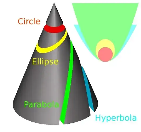

Assuming a perspective projection and a view point external to the sphere, then the 'boundary' formed by the view point and the circle on the sphere which forms the horizon WRT the view point, will be a cone.
Doing a perspective projection (onto a plane) is then equivalent to intersecting this cone with the plane which thus produces a conic section. FYI the four, non-degenerate, cases are shown in this image from Wikipedia enter image description here
An ellipse/circle is thus a possibility, but not the only one - unbounded parabolas or hyperbolas (and I guess if the plane passes through the eye, even degenerate cases ) are possible.

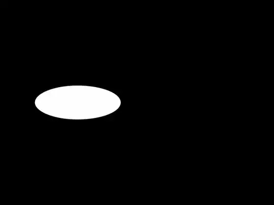

All cuts of cone are possible, hyperbola, parabola and ovals. This is easy to test by drawing images in a 3D engine by a extremely wide angle camera. Rotate the camera to say in 30 degree angle so the object is not in the middle of your focus. Then gradually move the camera closer to the sphere.
Image 1: Flying very close to a sphere looking slightly sideways. Notice how we suddenly puncture the surface form inside.
So to recap when the sphere is very close so it exits the picture in wide image it can be a parabola or hyperbola. But the shape will just exit the frame to do so.

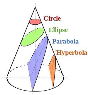

Cutting a conic with a horizontal plane creates a circle.
Cutting with an oblique plane creates a bevel which would be an ellipse or a hyperbola depending on the cutting angle, and when this angle inclines to be vertical in will create a parabola (following picture).
Ellipse

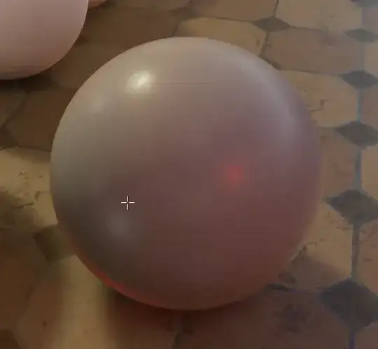

SimonF's reasoning basically convinced me, but I decided to do a sanity check. I loaded up a UE4 level that happens to have some spheres, like this one:
I set the camera FOV up to 160 degrees to give lots of perspective distortion, and positioned it so the sphere was near the corner of the image:
Then I took this into Inkscape and used the ellipse tool to draw on it:
Surprise! It's a perfect fit!
