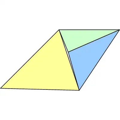

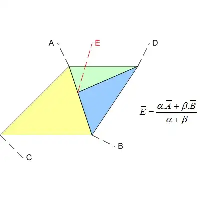

lhf's answer is good from the perspective of tessellation, but these can occur with simpler triangle mesh use cases.
Take this trivial example of three, screen-space triangles, ABC, ADE and DBE...
Although point E was, mathematically, intended to be exactly on the line segment AB, the pipeline won't be using fully precise values, such as rational numbers (e.g. https://gmplib.org/). Instead, it will likely be using floats, and so some approximation/error will be introduced. The result is probably going to be something like:
Note that all of the vertices may have inaccuracies. Although the example above shows a crack, the T-junction may instead result in overlap along the edge causing pixels to be drawn twice. This might not seem as bad, but it can cause problems with transparency or stencil operations.
You might then think that with floating-point the error introduced will be insignificant, but in a renderer, the screen-space vertex (X,Y) values are nearly always represented by fixed-point numbers and so the displacement from the ideal location will usually be much greater. Further, as the rendering hardware "interpolates" the line segment pixel-by-pixel with its own internal precision, there is even more chance it will diverge from the rounded location of E.
If the T-junction is "removed" by, say, also dividing triangle ABC into two, i.e. AEC and EBC, the problem will go away as the shifts introduced by the errors will all be consistent.
