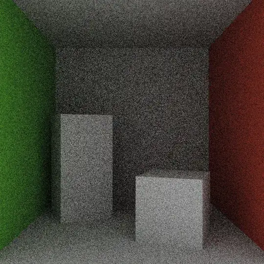

I was trying to do importance sampling on lambertian surface.At first I uniformly choose direction from unit sphere.
vec3 direction = camera->genDirection();
direction = random_in_unit_sphere();
float cosine = dotp(direction,surfaceNormal);
float dotp(float val){
val = dot(val);
if(val>0.0001f) return val;
else return 0.0001f;
vec3 brdf_result = material->baseColor/Pi;//lambertian
vec3 pdf = 1.0f/(2.0f*Pi);
throughput = throughput * brdf_result * cosine / pdf;
With 10 samples per pixel,yields:enter image description here
then I choose random direction from the unit hemisphere above the surface
direction = random_in_unit_hemisphere(surfaceNormal);
vec3 pdf = 1.0f/(1.0f*Pi);
the result is very similar,except for less noise enter image description here

however the result is different: enter image description here
The baseColor of the wall is vec3(0.8f,0.8f,0.8f),and the color of the dome light is vec3(1.0f,1.0f,1.0f). In some tutorial the cosine item is inside the lambertian brdf,and some are in the render equation,and in http://in1weekend.blogspot.com/ "weekend one" there is no cosine item at all.I really get messed with those concepts.Is there any one help me?thanks so much.
another rendering with baseColor = vec3(1.0f,1.0f,1.0f) and dome color = vec3(0.5f,0.5f,0.5f) (importance sampling) the average color of the final image over all pixels is vec3(0.470884f,0.470884f,0.470884f). enter image description here 10,000 samples per pixel with uniform hemisphere sampling:

  • @DirectX_Programmer,Thanks for answering!I have replaced pdf back to "pdf = 1.0f/(1.0f*Pi)",that work,the image was back to the more realistic dark one,however it was still slightly different from the first one.I think the pdf item is to downweight the overweight part "uvw.local(randCosDir())",but it seems that the pdf didn't do the job very well,it downweight too much!I've try another importance sampling method from(https://computergraphics.stackexchange.com/questions/4979/what-is-importance-sampling),but it was still,too bright,or maybe that was what lambertian actually looks like! – dsukrect Aug 24 '20 at 10:45
  • @dsurekt I guess that best solution would be to create raytracing algorithm accumulating over frames (for uniformly sampled raytracing), converging to ground truth over time and compare your single frame results with that. – DirectX_Programmer Aug 24 '20 at 11:00
  • @DirectX_Programmer,I've added the rendering with 10,000 samples per pixel(uniform hemisphere sampling)at the bottom of my question,It should be the correct lambertian look.I don't know why importance sampling will result in different image... – dsukrect Aug 24 '20 at 11:27
I just found that if I use pdf = 1.0f/(4.0f * Pi) in unit sphere sampling or pdf = 1.0f/(2.0f * Pi) in unit hemisphere sampling,the result are almost the same as the importance sampling one(I also get the same result when set the baseColor to vec3(0.4f,0.4f,0.4f),the half of vec3(0.8f,0.8f,0.8f). And the surface area of a unit sphere is just 4.0f * Pi(I forget why I use 2.0f * Pi before).I HAVE to come to two conclusions:
1: the importance sampling one is correct!
2: I'm too stupid!!!!!!
