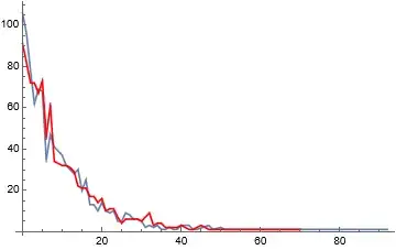

EDIT! As announced, here is the output of a very primitive simulation. We have an array A of length 1000 (players), with p=0.01 a chessplayer drops out and at the same time a new one starts at 0 (which is of course not realistic). With q=0.1, a player gets a new tournament rating (again, as stated in a comment, more than one should be updated). Essentially the only free variable is p/q (assuming both are smallish). Red: 50000 runs, Blue: 100000. (A player with 92 rated tournaments leads by far.) Evidently, a dynamic steady state was reached.

    That's an outcome I probably will not experience :-) My first experiment will be: constant and equal "in" and "out" rates, and a constant probability for anyone to play a tournament, in one time step. Even then I expect a very non-even distribution, since the "methuselahs" simply had more time to collect tournaments. The "steady" state is dynamically steady. – Hauke Reddmann Dec 05 '21 at 17:41

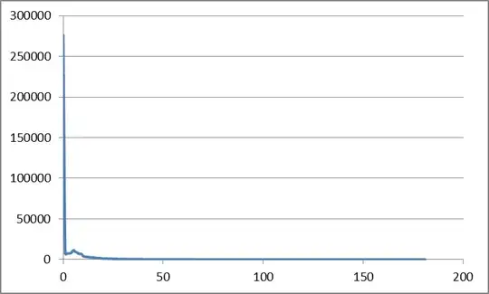

Here is a graph of the number of players (y-axis) who played x number of games (x-axis) so far in 2022. These are FIDE rated at standard time control:
Not all that useful really because 276,251 have played zero games so far this year. Let's try again but remove that data point.

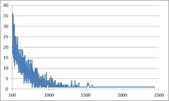

For balance let's look at the fanatics, those who played 500 or more games during the 12 years.
One player played 2442 games, about 200 games a year and 156 players played 1200 or more games.
