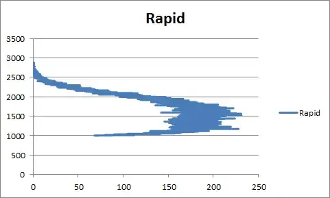

I've run some queries against my database constructed from the rating data downloaded from the the FIDE download site. I've then copied the output of the queries to Excel and asked it to draw some graphs.
Here are the results for standard, rapid and blitz for December 2020.
Standard rating distribution
Rapid rating distribution
