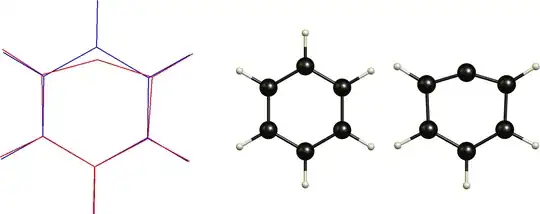

  1. Phenyl cation/ Aryl carbocation
    In this case we have a cationic carbon which is already planar. Therefore the necessary change would be to adopt a linear coordination. This obviously is restricted by the cyclic backbone.
    Benzene and the Phenyl cation Technically this is not a non-classical carbocation according to the definition (or is it?), which is one of the reasons why I don't like this definition in the first place.
    A true non-classical version with a bridging proton is not a stable stationary point on DF-BP86/def2-SVP.
    While the bridging $C_\mathrm{5v}$ symmetric $\ce{^+C(CH)5}$ is a stationary point, it is about $\pu{145 kJ mol-1}$ higher in energy.

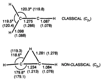

  2. Vinyl cation
    tl;TL;DR;dr: More recent work indicates that the bridged form of the vinyl cation with is slightly more stable (by about 1-3 kcal/mol).
    Classical vs non-classical vinyl cation
